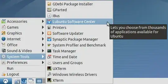

You can use Lubuntu Software Center in order to install new software on your system.
  • From Lubuntu 12.04 onwards, it comes preinstalled.
  • If for some reason you don't have it, install it:
    sudo apt-get install lubuntu-software-center
