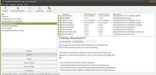

I would like to give a GUI solution.
  1. Open Synaptic Package Manager.
  2. Go to Status.
  3. Click Installed (manual).
It will give the list of packages installed manually by apt or aptitude.
Unfortunately I could not find any option in Custom Filters to find out whether a foobar package was installed manually or automatically.
If the package is under Installed but not under Installed (manual), then it was installed automatically. If the package is under Installed (manual), then it was installed manually.
