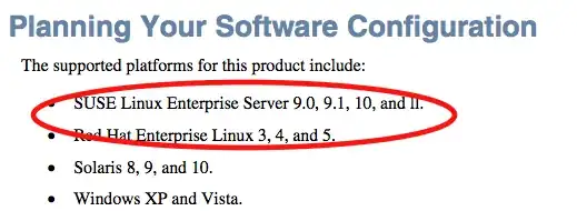

I happen to install model sim VHDL simulator on Linux. The manual says it only supports RedHat or Suse, but I just tried to install it on Ubuntu. And, I could install it without any problem.
  • Is linux binary universal to all kinds of distribution? I mean, if I make a program on distrubution A, can I be sure it will run on any linux?
  • Why most of the commercial program vendor says the program is running on specific distribution? (mostly Redhat and Suse, not ubuntu)
