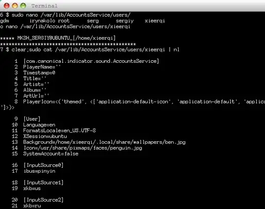

You could also specify the default desktop session in the file /var/lib/AccountsService/users/yourusernamehere , specifically on line 12, where it says XSession

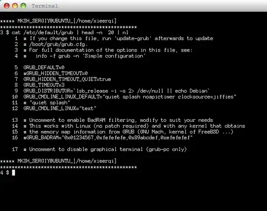

If what you want is to boot into command line and then start x server manually, here's what you can do:
Open /etc/default/grub with your favorite text editor (note, you must use sudo)
and edit line GRUB_CMDLINE_LINUX="text", which is in screenshot bellow is line 12
Save the file, run sudo update-grub and reboot once done. Once you boot up, you will be prompted to login into tty, run sudo service lightdm start, where lightdm is whatever greeter/desktop manager you want to use or have
