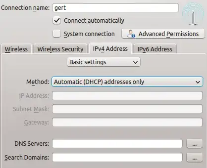

the wireless network with ESSID Foo needs a nameserver on address 10.32.5.12 plus one on 8.8.8.8
You can already configure this in the Network Manager:
