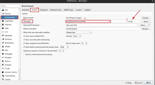

19
  1. Go to Tools-> Options-> Environment
  2. In the Tab General under **System** Group there is a Terminal Option.
  3. The default value is set to/usr/bin/xterm -e. Replace it with /usr/bin/xterm -e sudo or /usr/bin/gnome-terminal -x sudo.
  4. Press Apply and OK Buttons.
  5. Under Mode Selector click on Projects, select Run Option. Under Run Group Box select Run in Terminal.
Remember : sudo option must be there
Edit /etc/sudoers using sudo visudo
Next time when you run the program it will be invoked in a new xterm or gnome-terminal with Super User Permission and will ask for the root password.
screen shot of the result

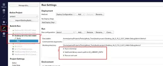

One easy way is to run the project in a terminal check Run as a Root user.
Here is Screenshot to show steps:
