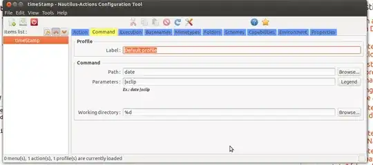

  1. Using nautilus-actions
I set up a new right-context action which runs the command date|xclip
This right-context doesn't show up when I right click in other applications (such as terminal, or browser). Moreover when it appears, and I click on it, it doesn't do anything.

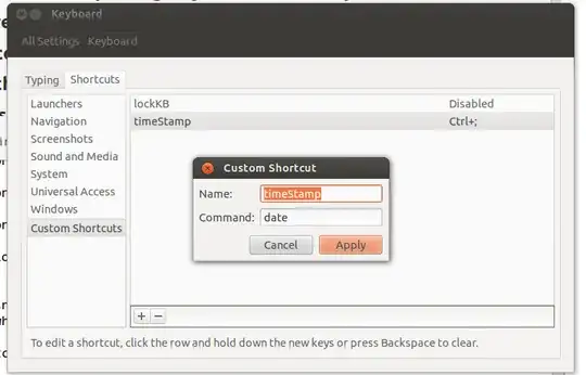

  1. Using keyboard shortcut
I setup a new keyboard shortcut which is supposed to execute date command but doesn't.

GNOME keyboard shortcuts should work.
Here's why what you tried didn't work: Your keyboard shortcut runs the date command, but does nothing with the output (which just gets discarded). You should pipe it to xclip, as date | xclip to copy it to the X selection (not clipboard). Then you can paste it into your document by middle-clicking. If you want to be able to use Ctrl-V, instead use date | xclip -selection c to copy it to the actual clipboard.
Another alternative is to use xdotool to type the date directly into your document. Assign to your shortcut
xdotool type "$(date)"
Then, when you press the shortcut key, it will calculate the current date and type the characters it into your document.
For ISO 8601 format, use xdotool type "$(date --rfc-3339=s)".
If it doesn't work: Because these are shell commands (as opposed to executables), you might have to pass the command to bash when specifying them in your shortcut. Your command would then be:
bash -c 'xdotool type "$(date --rfc-3339=s)"'
I've been successfully using this as a custom keyboard shortcut assigned to Ctrl+Shift+D:
bash -c 'sleep 0.3 && xdotool type "$(date -u +%Y-%m-%d_%H:%M:%SZ)"'
I found adding a slight delay solved the issues with missing initial characters, and doesn't pollute my clipboard.
Note that I'm using a slightly customized version of RFC 3339/ISO 8601 format: I often use this in contexts where I want to avoid the space in date's RFC 3339 output, but I find the T that separates the date from the time in ISO 8601 timestamps rather unintuitive and difficult to read, so I find an underscore works well.
bash -c 'xdotool keyup super && xdotool type "$(date +%Y.%m.%d)"'
I use Super+Q as my shortcut, and I need to clear the super modifier before sending the date. I tried --clearmodifiers but that would cause the unity dash to pop up after the shortcut is run [1]
