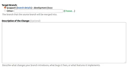

On the next page, select your target branch and give an overview of your changes.

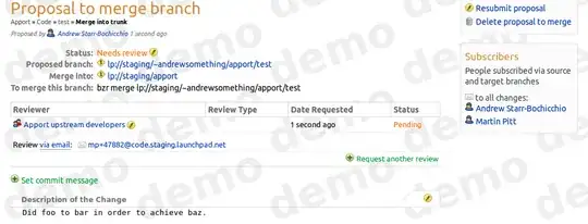

You will now have an active merge proposal.
active review
The maintainers will review your changes. If they are appropriate, they will be merged and be available in the next release. Alternatively, the proposal may be set to "Needs Work," and the maintainers will discuss with you additional changes that should be made before merging. If this happens, please don't take it as any kind of personal rejection of your work. When contributing to a new project for the first time, there are often little things like coding style that you might not be aware of.
