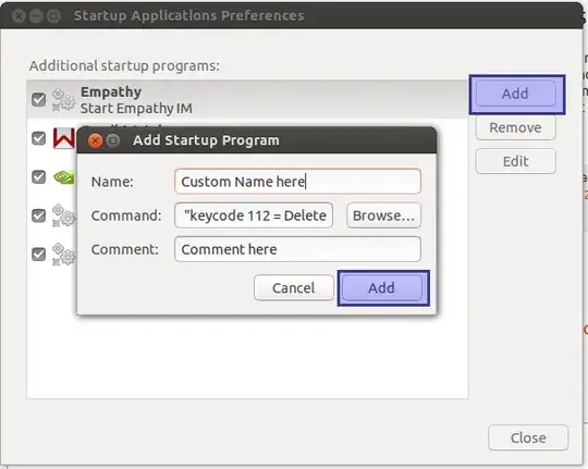

You can make it run at boot by adding it in startup applications. Open startup applications from the dash. Click 'Add' and put xmodmap -e "keycode 112 = Delete" in the 'Command' field. Give it a name and comment if you want. Click 'Add' and login again.
