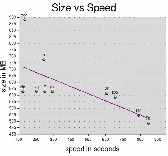

Here is the results for a 1.4 Gb virtualbox container:
Best compression – size in MB:
7z 493
rar 523
bz2 592
lzh 607
gz 614
Z 614
zip 614
.arj 615
lzo 737
zoo 890
Source

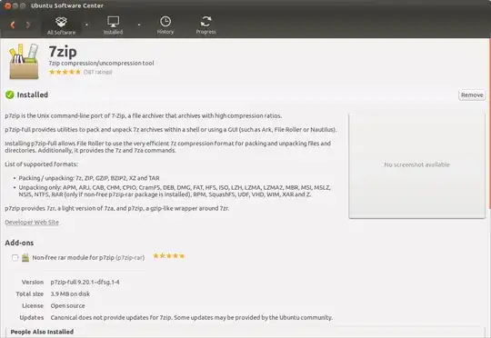

Install
 sudo apt-get install p7zip-full
