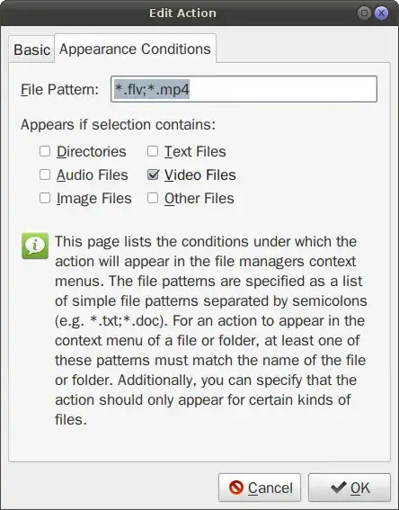

I use such commands in Thunar custom actions,
limiting the application to videos that contain aac audio.
To have a terminal window open during processing, which closes at the end, the command can be changed like:
 gnome-terminal -e "parallel avconv -i '{}' -map 0:1 -c:a copy '{.}.m4a' ::: %F"
