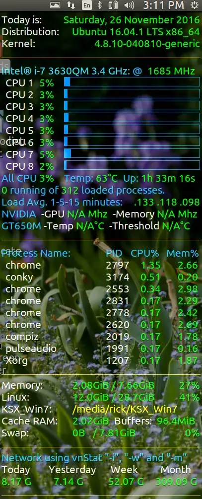

Temperature with Conky
Within conky the system variable I used to monitor an Ivy Bridge CPU is:
${hwmon 2 temp 1}°C
To monitor a Skylake CPU I initially used:
${hwmon 0 temp 1}°C
A few months later (possibly due to new kernel) on the same Skylake CPU I switched to:
${hwmon 1 temp 1}°C
The display looks like this:
Conky Temperature 4.8.10
