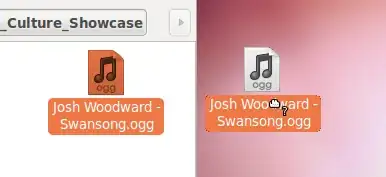

If you Middle-click drag and drop (or press Alt after you've started moving the icon so that it doesn't trigger the window move) and then let go of the file a context menu shows up giving you the choice of Copy, Move, link, etc.
Example dragging a file onto my desktop:
The cursor will have a little question mark by it, then when you let go this pops up:
