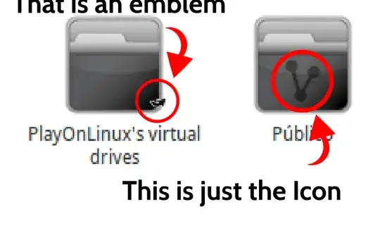

Those are not emblems, in the image below you can see that the emblems are located in the lower right part of the Item (in this case is a symlink/shortcut).
The Icons for the user folders usually have a little representation of what that folder is all about. Those folders are "special" and are different from the rest of the folders on your system. In this example the folder is Shared/Public stuff, next to this is a regular folder.

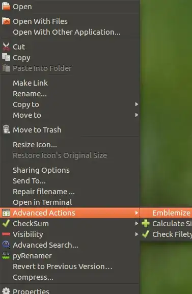

You can use the Emblemize script to edit and inspect emblems (works with 11.10 and 12.04)
Installation
sudo add-apt-repository ppa:dr3mro/nautilus-actions-extra
sudo apt-get update
sudo apt-get install nautilus-actions nautilus-actions-extra nautilus-gksu
Re-start Nautilus...
nautilus -q
Result:
