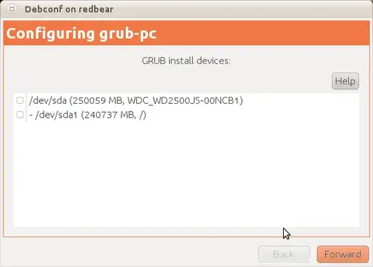

After running Update Manager, a debconf window (titled "Configuring grub-pc"), popped up, requiring me to select the appropriateGRUB install devices for my system. I've made no changes to grub or the filesystem recently, and I don't remember what options I selected last time I did make a change.
How do I know what to select? I'm assuming the wrong answer could render my system unable to boot.
Here's the debconf dialog:
Debconf window, configuring grub-pc, containing check-boxes for /dev/sda and /dev/sda1

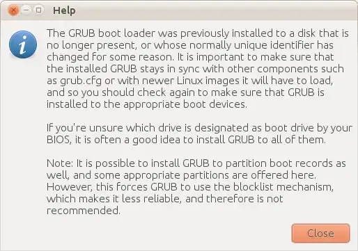

Here's the window and text that is displayed when selecting "help" :
Grub was previously installed to a disk that is no longer present

In your case, the correct selection is /dev/sda, the first one. It's the first and only hard disk in your system, whereas /dev/sda1 is a partition on that hard disk. You can install grub on a partition, but it's a "BAD idea".
If you had multiple hard drives and partitions, first find out where your root partition is:
lsblk
(See also: How do I find out what hard disks are in the system?)
You can then install grub on that hard drive. Look for devices labeled "disk" (e.g. "sda", meaning /dev/sda) to install grub into the master boot record (every physical disk device has only one MBR, no matter the partitions).

This issue was still present when I upgraded Ubuntu 16.04 after a fresh install. To fix it, do this:
  • The selection of /dev/sda is correct, so press Spacebar for the first option.
  • An asterisk appears for the /dev/sda option, signifying successful selection.
  • Then press Tab key to highlight the 'OK' button and then press Spacebar key to select the OK action.
After this, the installation should proceed smoothly.
