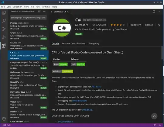

You could use Visual Studio Code using apt:
wget -q https://packages.microsoft.com/keys/microsoft.asc -O- | sudo apt-key add -
echo "deb [arch=amd64] https://packages.microsoft.com/repos/vscode stable main" | sudo tee /etc/apt/sources.list.d/vscode.list
sudo apt update
sudo apt install code
or snap:
sudo snap install code --classic

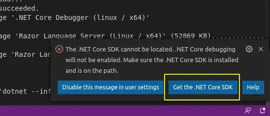

After the C# package installing, the next dialog box appears:
Clicking the marked button opens the next page, which provides the instructions for .Net Core SDK installation (along with ASP.Net Core runtime and .Net Core runtime installation instructions):
wget https://packages.microsoft.com/config/ubuntu/19.10/packages-microsoft-prod.deb -O packages-microsoft-prod.deb
sudo apt install ./packages-microsoft-prod.deb
sudo apt-get update
sudo apt-get install apt-transport-https
sudo apt-get update
sudo apt-get install dotnet-sdk-3.1
