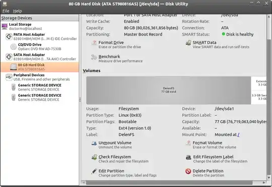

If it's possible to run the LiveCD, you can use the gui tools to fix the issue, you can do all this using the System > Administration > Disk Utility once you're booted into the LiveCD desktop:
disk utility screen
Once you've run the checks, make sure your disk isn't full (delete some stuff if you have to) and then reboot.
