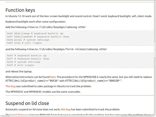

I added the keymaps as per community docs - Samsung Series 9 (section Function Keys). But regardless of pressing Fn+F9 or F10 (backlight decrease/increase), I get:

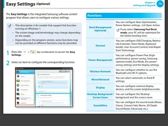

You could download Easy Settings from manufacturers webite after making sure you have the exact model or are on the right page for your specific model. That is if you have a Windows to use to at least confirm everything does work as expected.
The Community Documentation confirms the scancodes at least are the same for 9 series and includes your model as being confirmed working after configuration i.e. installing kernel module and editing two files.
Here is quote from https://help.ubuntu.com/community/SamsungSeries9
