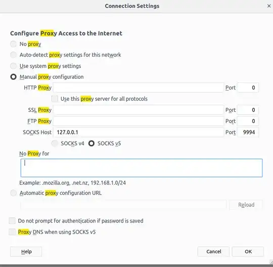

Here's a comprehensive solution:
  1. Make a tunnel (dynamic port forwarding) over SOCKS5 protocol using ssh:
    ssh -ND 9994 -C user@YourSshServer
    or if you have to use a specific port to SSH:
    ssh -ND 9994 -C -p xxxx user@YourSshServer
  2. Configure the FireFox preferences via searching Network Proxy and hit on Settings... as follows:
Now the Firefox is able to browse over all of the existing HTTP ports properly.
