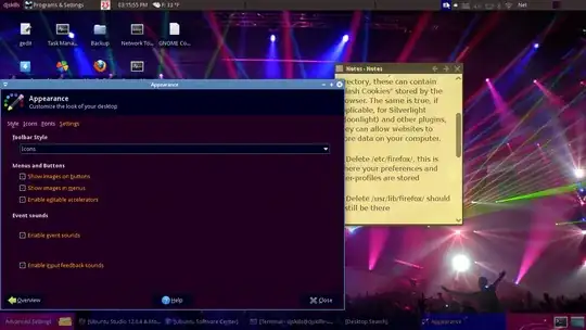

Here is a Screenshot of the Ubuntu Theme on my desktop before the assumption is made that my applied Firefox Theme is causing the "Light Grey Text" you see. You may view this below:
Ubuntu Studio 12.0.4 (Low Latency) Desktop Theme

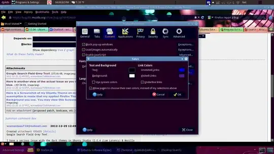

The "Light Grey Text Form Field Issue" has been present way before I added my Mozilla Firefox 17.0.1 Theme. Whensoever I choose the default "Ubuntu 12.0.4" Theme the "Light Grey Text" issue disappears as the input text becomes Black. I've done a complete uninstall of Mozilla Firefox 17.0.1 in an attempt to remedy this issue utilizing the "Synaptic Package Manager". I was also sure to purge any remnant Mozilla Firefox files (customizations etc.). As an added step I've also been sure to review any Mozilla Firefox settings that may be causing this issue. This is just one more Screenshot so that you can see the "Use System Colors" check box under Firefox Preferences is unticked:
Use System Colors Mozilla Firefox Preferences Unticked
