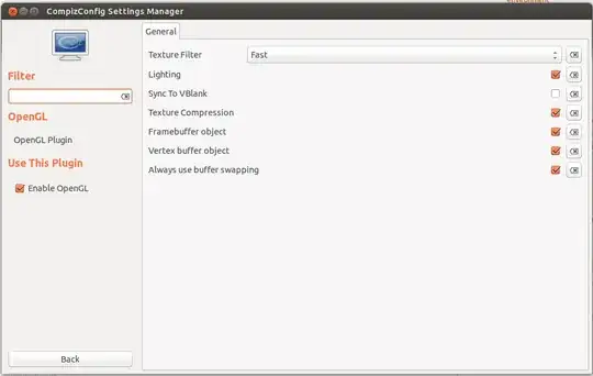

Well install the Compiz Config Settings Manager (ccsm)
and play with the OpenGL plugin:
Some of this options will enhance performance, others I needed to avoid video problems. If anybody finds the question about this I will be happy if they edit this answer to include a link to it here. I can't find it right now but I know there was an answer that talked about this.
