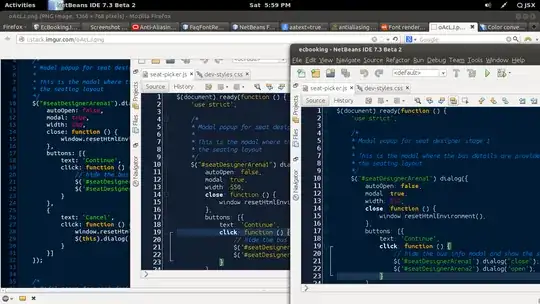

See the attached image. The window in the background is gedit with the fonts rendered smooth. The window on top is NetBeans with not-so-smooth font rendering (not anti-aliased, I think). Both editors use Ubuintu Mono font. Can anyone help me to make NetBeans render the fonts better?
I'm on 12.10.

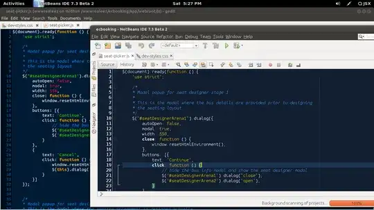

Fixed.
See this and this.
TL;DR: just add -J-Dawt.useSystemAAFontSettings=on -J-Dswing.aatext=true to netbeans_default_options in the netbeans.conf file.
(netbeans.conf is at <installdir>/etc/netbeans.conf)
Of course, restart NetBeans.
See the result screenshot below. The Netbeans window on the extreme right is the onc after the above options are applied. Still not as good as gedit, but better than before.
