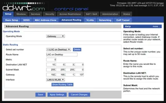

I used the default Ubuntu LXC settings, and configured my router to send all traffic on 10.0.3.xxx to the Ubuntu machine. On a DD-WRT enabled router, the settings look something like the screenshot below. Replace 192.168.1.137 with the IP of the machine running LXC. Other routers should have similar options to set up a static route (here are static route instructions for Linksys, for example).
DD-WRT settings for static routing to LXC

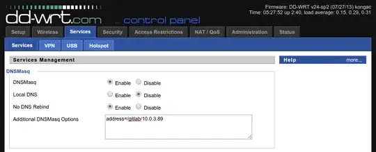

This is unrelated, but I also used the DNSMasq service to point a hostname to the LXC container's IP address. This way I can access the container at http://gitlab/ anywhere on the network. In my opinion it's a lot easier to use a hostname to access a container than remember the IP address.
DD-WRT DNSMasq settings
