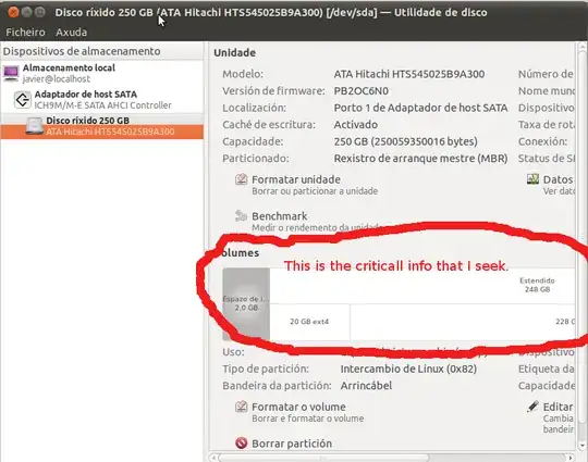

  • Please insert the Ubuntu CD again and boot your computer.
  • When asked choose to Try Ubuntu (not install it).
  • When Ubuntu has finished loading, go to the System Menu-> Administration->Disk Tool
  • Please give us the info from that screen. Specially the layout in the right side.
  • If you hit the Print Scrc key, it will take a screenshot of the screen. If you can post it here it could be very helpful.
Note that this is not really an answer, but this is too many information for a comment. It's likely that askubuntu is not the best place for this kind of problem.
Javier Rivera
  • 35,434
After looking at this image, seems like you have deleted your Vista partition.
You will need to run some specialized software to recover your files. I have found a nice tutorial. I have in the past get great results with foremost recovering data from damaged disk. Take a look at the tutorial.
After you had recovered your data you will need to reinstall Vista. To be able to do it you will need a CD or DVD with it. It's possible that you're computer included such a disk. If you don't have it, you should be able to get it from the manufacturer (usually with a cost) or download it from the net (caution: this can be illegal on some places even if you have paid for your windows). Installing Vista is quite of the scope of this question, and it can overwrite your Ubuntu install (you can avoid it if you're careful). Look for some tutorials in the net, and make a copy of all your important files in Ubuntu before starting.
