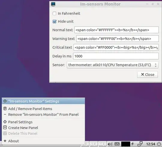

I have the similar problem (my default sensor always shows 40.0°C) and i can't change this sensor in original lxpanel's Temperature Monitor. But there is another solution: lm-sensors LXDE lxpanel plugin.
https://github.com/danamlund/sensors-lxpanel-plugin
It is simple to compile (in lubuntu 16.04 i also used debian install instructions) and simple to use:
