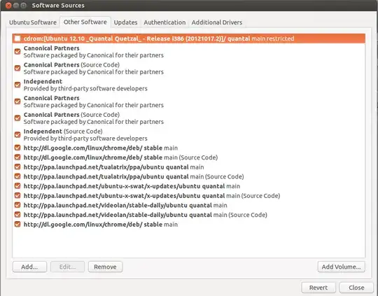

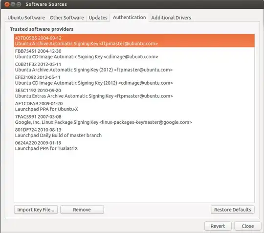

i also tried installing Softwares from Synaptic it also gives me errors of same kinds.. also there is a red triangle on the top right of my screen telling me:
the update information is outdated. this may be caused by network problems or a repository that no longer exists,
now i searched a lot on web on trying to solve this problem so i ran plenty of repositories to see if they work.. but non of them worked..
i checked also my software sources, i ticked or Unticked everything on "other software" tab, but still nothing changed.
this is how my software sources is now: picture 1
picture 2
picture 3
picture 4
