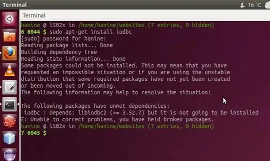

I need to install the library iodbc (depends on libodbc2) in my Quantal machine. Yet there is creepy dependency problem. This was replaced somehow by unixodbc which I don't have, installed. Here is what I get when I try to install :
install iodbc failure
sudo apt-get install libiodbc2-dev
Reading package lists... Done
Building dependency tree
Some packages could not be installed. This may mean that you have
requested an impossible situation or if you are using the unstable
distribution that some required packages have not yet been created
or been moved out of Incoming.
The following information may help to resolve the situation:
The following packages have unmet dependencies:
 libiodbc2-dev : Depends: libiodbc2 (= 3.52.7-2build2) but it is not going to be installed
                 Depends: iodbc (= 3.52.7-2build2) but it is not going to be installed
E: Unable to correct problems, you have held broken packages.

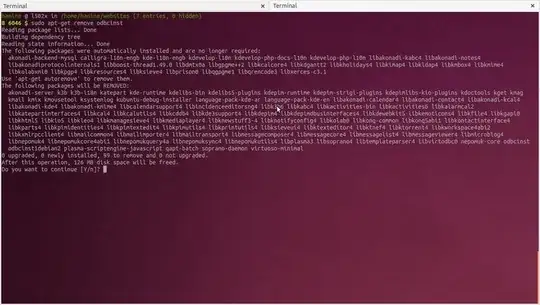

I can tell that iodbc conflicts with odbcinst. Yet, I cannot remove it due to the following:
sudo apt-get remove odbcinst
The following packages were automatically installed and are no longer required:
  akonadi-backend-mysql calligra-l10n-engb kde-l10n-engb kdevelop-l10n kdevelop-php-docs-l10n kdevelop-php-l10n libakonadi-kabc4 libakonadi-notes4
  libakonadiprotocolinternals1 libboost-thread1.49.0 libdmtx0a libgpgme++2 libkcalcore4 libkdgantt2 libkholidays4 libkimap4 libkldap4 libkmbox4 libkmime4
  libkolabxml0 libkpgp4 libkresources4 libksieve4 libprison0 libqgpgme1 libqrencode3 libxerces-c3.1
Use 'apt-get autoremove' to remove them.
The following packages will be REMOVED:
  akonadi-server k3b k3b-i18n katepart kde-runtime kdelibs-bin kdelibs5-plugins kdepim-runtime kdepim-strigi-plugins kdepimlibs-kio-plugins kdoctools kget kmag
  kmail kmix kmousetool ksystemlog kubuntu-debug-installer language-pack-kde-ar language-pack-kde-en libakonadi-calendar4 libakonadi-contact4 libakonadi-kcal4
  libakonadi-kde4 libakonadi-kmime4 libcalendarsupport4 libincidenceeditorsng4 libk3b6 libkabc4 libkactivities-bin libkactivities6 libkalarmcal2
  libkatepartinterfaces4 libkcal4 libkcalutils4 libkcddb4 libkde3support4 libkdepim4 libkdepimdbusinterfaces4 libkdewebkit5 libkemoticons4 libkfile4 libkgapi0
  libkhtml5 libkio5 libkleo4 libkmanagesieve4 libkmediaplayer4 libknewstuff3-4 libknotifyconfig4 libkolab0 libkonq-common libkonq5abi1 libkontactinterface4
  libkparts4 libkpimidentities4 libkpimtextedit4 libkpimutils4 libkprintutils4 libksieveui4 libktexteditor4 libktnef4 libktorrent4 libkworkspace4abi2
  libkxmlrpcclient4 libmailcommon4 libmailimporter4 libmailtransport4 libmessagecomposer4 libmessagecore4 libmessagelist4 libmessageviewer4 libmicroblog4
  libnepomuk4 libnepomukcore4abi1 libnepomukquery4a libnepomuksync4 libnepomukutils4 libplasma3 libsoprano4 libtemplateparser4 libvirtodbc0 nepomuk-core odbcinst
  odbcinst1debian2 plasma-scriptengine-javascript qapt-batch soprano-daemon virtuoso-minimal
0 upgraded, 0 newly installed, 89 to remove and 0 not upgraded.
After this operation, 126 MB disk space will be freed.
Do you want to continue [Y/n]?
odbcins uninstall failure Other info: Why do the "iodbc" and "libmyodbc" packages conflict with each other?

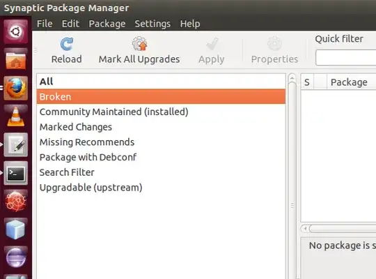

I have no broken packages: No Broken packages
