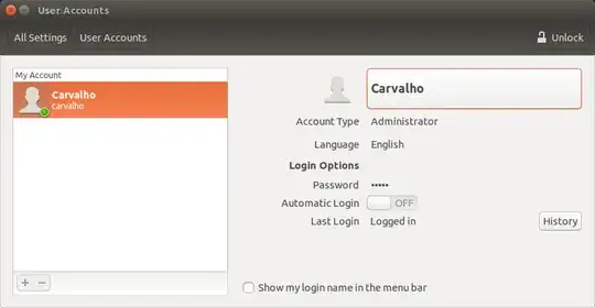

To change the user's display name (the one that appears at the login screen), go to System Settings -> User Accounts then click the display name on the right-hand side of the dialog.
