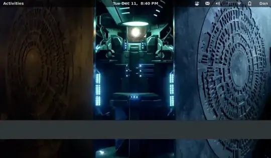

About a week ago I noticed my notification area had roughly it's own height from the bottom of the screen. How can I move it back to the bottom?

It was an extension I had installed called "Panel Settings". link

Remove Main.messageTray.actor.get_parent().get_height() at line 550 of Panel Notification extension.js.
