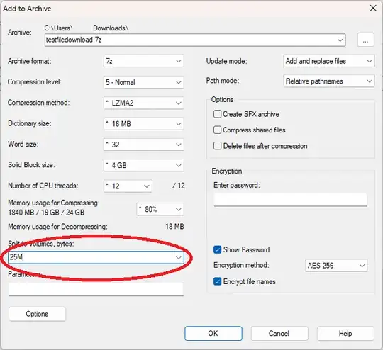

I would use 7Zip. It is available for Ubuntu and Windows (download link here). A GUI is available for either operating system, but you can just as easily use a CLI. There is a textbox (in the GUI) where you put the size of each split zip file. You can use K (kilobyte), M (megabyte), or G (gigabyte) for sizes that are not included in the dropdown menus.
7Zip split volumes:
7Zip Split Volumes
Through the CLI, you can use the -v switch to determine the volume size.
In order to reassemble the files, decompress the first file (i.e. *.zip.001). 1
