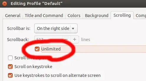

Go to Edit -> Profile Preference -> Scrolling Tab
Now just tick the Unlimited box below Scrollback.
You will now be able to see your entire output.

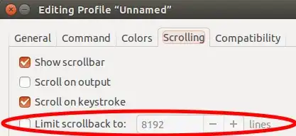

Since the question is now over three years old, I just want to post an update:
In Ubuntu 15.10 it is pretty similar to the accepted answer, there it looks the following:
  • Go to Edit -> Profile Preference -> Scrolling Tab.
  • Untick the box beside "Limit scrollback to:".
Disable "Limit scrollback to:"
