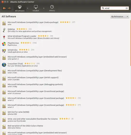

I have Ubuntu 12.04 64bit.
I tried to install WINE in 11.10 but met with some difficulties because of which I removed it. I tried to install Assassin's Creed 1 but turned to be a catastrophe.
Now I want to try again. However, I am confused as to which of these packages am I to install, avoiding crashes, clashes, system failures system damage and ensuring running smooth installation of games.
I need help regarding compatibility and dependency.
I viewed this answer and as per the update & want the latest developing branch.

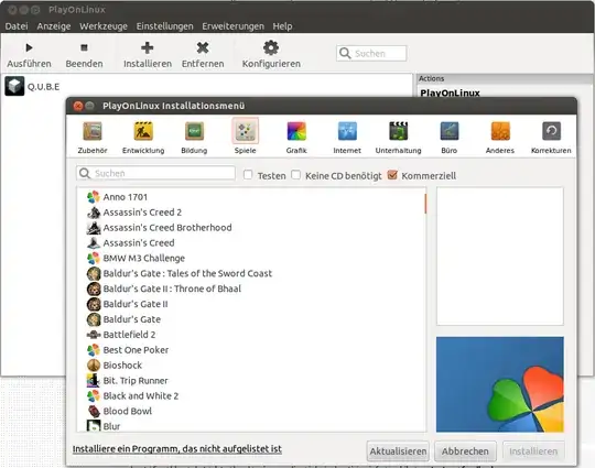

Wine Windows Programmloader is wine itself. I suggest you to use PlayonLinux its a great GUI for managing the installation of programms using wine and comes with many scripts for programminstalls. It will either download a preferred wine version for each programm (if there is an installscript given for that one).

The best way is to install it via terminal. (or you can use Synaptic)
sudo apt-get install wine
This will install wine and all packages that are needed. In Ubuntu 12.04 it will install Wine 1.4.
If you want to use Wine 1.5 you can use a PPA
sudo add-apt-repository ppa:ubuntu-wine/ppa
sudo apt-get update
sudo apt-get install wine1.5
If you try to install specific Windows software, you should have a look on this site: http://appdb.winehq.org/
There you can find additional infos what you need for which software.
