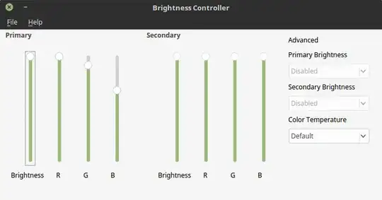

Install Brightness Controller with the following commands:
sudo add-apt-repository ppa:apandada1/brightness-controller
sudo apt-get update
sudo apt-get install brightness-controller
You can control brightness using its slider.
