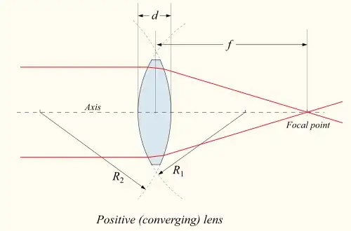

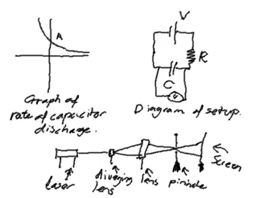

I want to draw mathematical pictures like graphs but just simple ones like a quick sketch of an exponential decay crossing at a point marked A or something like that, and I want to draw a picture of a diagram of some equipment, like a lens and a light ray being sent through a pinhole and projected onto a screen. Diagrams like this: Picture of what I want to draw, but I want it neater
But so they look more like this:
Wikipedia picture of circuit
and:
Wikipedia picture of lens diagram
Is there any software on Ubuntu that'll let me do this easily and accurately?

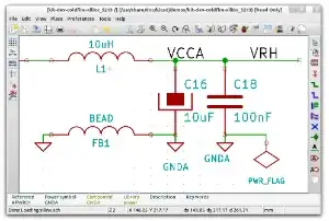

I would suggest KiCad. It is an application that helps you create professional schematics and printed circuit boards.
You can easily install it by adding the following PPA to your system:
sudo add-apt-repository ppa:adamwolf/kicad-testing-daily
sudo apt-get update
sudo apt-get install kicad kicad-doc-en
