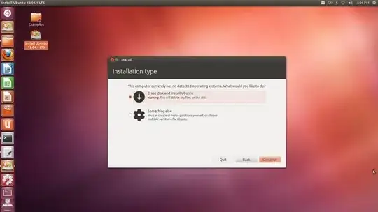

From other questions raised, I read that if Ubuntu Live USB boots in UEFI mode then it should detect Windows 8 during installation. During installation, I only see two options, Erase disk and install Ubuntu and Something else. I don't want to Erase disk and install Ubuntu but Install Ubuntu alongside windows 8. How can I enable the Ubuntu 12.04 Live CD/USB to detect the existing Windows 8? Thanks.
Sorry the latest response.
@Rod here are the screenshots as requested:

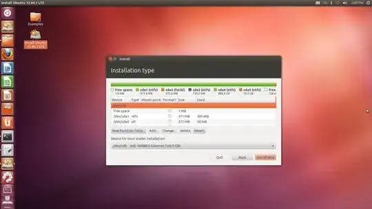

Installation type Partition table

Mount EFI to /boot/efi but DO NOT FORMAT then after that, mount your other partitions (eg /home /). Install and reboot. You will now boot to Ubuntu so you can configure grub.cfg to be visible and add a Windows option. I have no experience in installing Ubuntu on EFI as I am an Arch user but this should help. EDIT
This will not work if you did not boot Ubuntu from UEFI. To boot DVD/USB in UEFI keep it enabled but disable secure boot option in BIOS. Do all as root sudo -i or su root List all your partitions with cat /proc/partitions Make an efi directory mkdir /boot/efi Mount your EFI partition eg: mount /dev/sdX /boot/efi Install grub-efi apt-get install grub-efi Finally, install grub. Grub will automatically add option to Firmware Boot Manager. grub2-install --target=x86_64-efi --efi-directory=/boot/efi --bootloader-id=Ubuntu --recheck --debug
