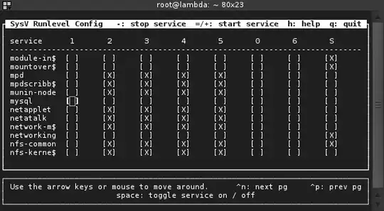

There is CLI based tool named as sysv-rc-conf Install sysv-rc-conf. You can also get it installed by running the following command in terminal:
sudo apt-get install sysv-rc-conf
Then you can activate/open it by running:
sudo sysv-rc-conf
Screenshot:
