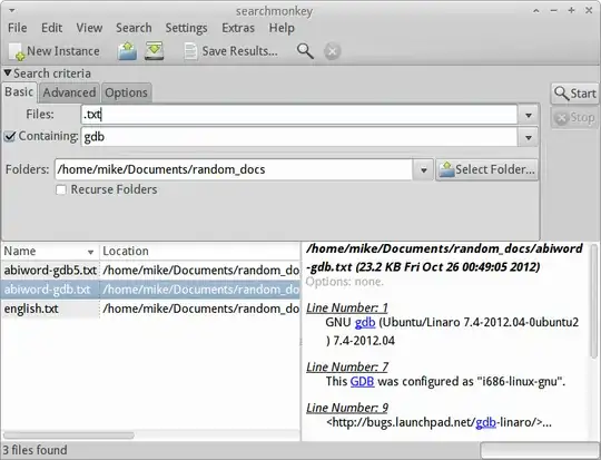

Yes, searchmonkey can search inside the selected file and the advanced settings and options contain ways of refining the search so that case is matched, ignored, or wildcards can even be specified. You can also construct your own regular expression to use if you have a particularly complicated search request.
You can save the search criteria and results to a file, but with searchmonkey you can't modify the file that you are searching within, and you have to open it with your text-editor as the documentation notes.

The screenshot shows the search within a text file with searchmonkey:
