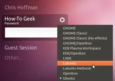

You can easily install and try out different desktop environments (instead of the default, Unity). Once installed, you can switch between different desktop environments at the log-in screen (there is an icon near your name, which, when clicked, allows you to select).enter image description here
Probably in your case, with 1GB ram, I would suggest the lubuntu desktop (based on LXDE). To install, open a terminal and type
sudo apt-get install lubuntu-desktop
If you don't want the whole environment, you can install LXDE by itself
sudo apt-get install lxde
Most everything will be the same but you'll have a new look that is less memory intensive (see many screenshots HERE). Firefox will be there, and the terminal will look a little different.
If you don't like the LXDE look, you can read about other desktop environments HERE. Options include Xfce (Xubuntu) and KDE (Kubuntu).

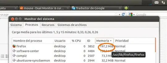

The web Browser
Firefox
Firefox is the default web browser of Ubuntu. It is a great browser but is not recommended for computers with minimal resources, since this has a large memory consumption. See Firefox working in my system:
firefox_mem_usage
