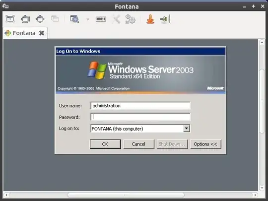

Perhaps not completely helpful, since Wishi has already suggested it, but for the record, there's no reason that Remmina should be displaying "terrible" fonts. You won't get Cleartype, sure, but they should still be slick and readable.
Here's a screenshot from my Windows 2003 box :
Remmina RDP Client

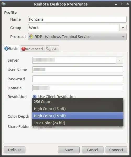

That's running 16-bit colour, though. In order to try that, go to the settings page in Remmina and change it from 256 colours to 16-bit :
Remmina Settings Page
