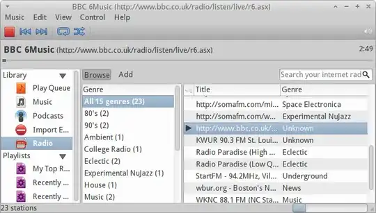

After adding the station in Music > New Internet Radio Station, and trying to play it, Rhythmbox should prompt you to install the necessary packages. This is what happened for me and then 6Music played.
If Rhythmbox doesn't prompt you to install the necessary packages, I got 6Music playing by installing the following additional packages on 12.04- the packages names might differ on 12.10. This is the list that Rhythmbox recommended, but not all are probably necessary:
sudo apt-get install libcdaudio1 libflite1 libgme0 libgstreamer-plugins-bad0.10-0 libmimic0 libofa0 libopenspc0 libslv2-9 libspandsp2 libvo-aacenc0 libvo-amrwbenc0 libwildmidi-config libwildmidi1 libzbar0 gstreamer0.10-plugins-bad
The gstreamer plugins are probably the most important, but installing the whole lot of recommended packages did get 6Music streaming.
Just to confirm:
you opened rhythmbox clicked on radio clicked the add button pasted the link http://www.bbc.co.uk/radio/listen/live/r6.asx into the box clicked on radio again and selected the link?
if you did this and got the error then try reinstall of the app.
ensure you have all your settings stored as I can't remember if you'll lose them.
sudo apt-get install --reinstall rhythmbox
then add the link again.
To change the title of the station to a recognizable one, right click on the title and click ‘Properties‘.
Hope this helps.
