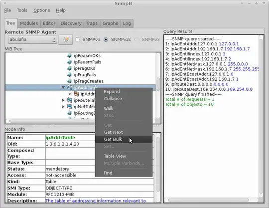

The same query can be run using a GUI based MIB browser, as well. Personally, I prefer using SNMPb for my graphical queries. Once you have SNMPb installed, open SNMPb and navigate to the desired OID in the MIB tree. In your specific case, it would be 1.3.6.1.2.1.4.20 or iso-> org-> internet-> mgmt-> mib-2 -> ip -> ipAddrTable and perform a Get Bulk to receive the same data.
