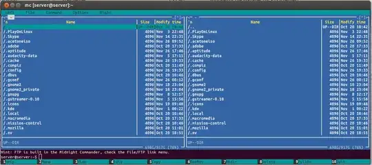

Well there is midnight commander:
mcscreenshot To install: sudo apt-get install mc
To run: mc

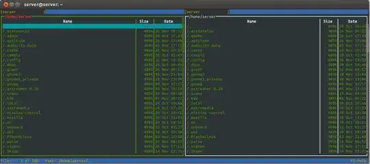

And also Last File Manager:
lfmscreenshot To install: sudo apt-get install lfm
To run: lfm

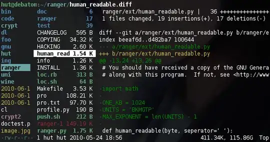

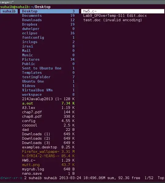

Ranger:
ranger is a file manager with VI key bindings. It provides a minimalistic and nice curses interface with a view on the directory hierarchy. The secondary task of ranger is to psychically guess which program you want to use for opening particular files.
  • UTF-8 Support
  • Multi-column display
  • Preview of the selected file/directory
  • Common file operations (create/chmod/copy/delete/...)
  • VIM-like console and hotkeys
  • Automatically determine file types and run them with correct programs
  • Change the directory of your shell after exiting ranger
  • Tabs, Bookmarks, Mouse support

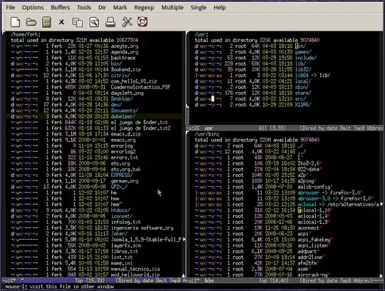

You could take a look at Dired Mode for Emacs. Though it's integrated to Emacs (so you have to learn the whole stuff), it's so much useful and nice to use that it could be nice to try it.
You can display a repository in in the console by running it in no-window mode:
emacs -nw /path/to/your/repository/
Dired is a visual directory editor, a computer program for editing file system directories. Dired runs on any Emacs platform. Its commands are generally more modal than most Emacs commands because Dired is a specialized major mode on its own. Dired can perform all expected operations; in operation and use it is akin to an orthodox file manager like Midnight Commander.
