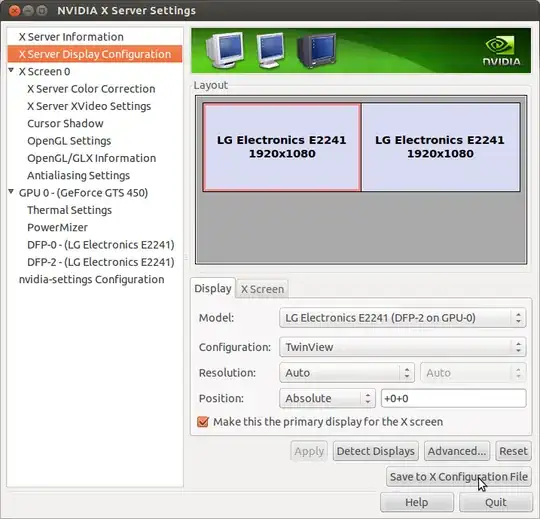

nvidia-settings
In nvidia-settings, under X Server Display Configuration, click Save to X Configuration File. If you've never done this before, it will complain about not being able to parse /etc/X11/xorg.conf. Just tell it "OK", it doesn't matter. You'll need to give it your password to elevate so that it can write to that file. Once you've done this, your resolution (and other changes in nvidia-settings) will persist through reboots.
