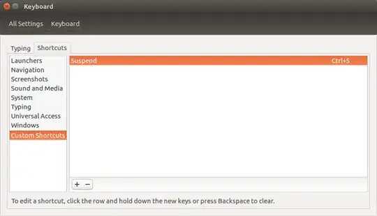

For Ubuntu 15.04. and later you can use from the terminal
systemctl suspend
Then create a shortcut in the settings/keyboard app with the same command.
key-sortcut
Easy!

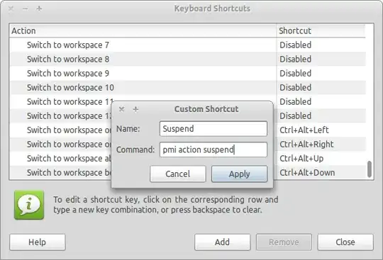

  1. Install the powermanagement-interface package first, it provides the pmi command we will use to suspend.
    UPDATE: I looked at the source for pmi and the command it uses to suspend is:
    dbus-send --system --print-reply --dest="org.freedesktop.UPower" /org/freedesktop/UPower org.freedesktop.UPower.Suspend
    If you can't install pmi, replace pmi action suspend with that command in the next step.
  2. Open up System -> Preferences -> Keyboard Shortcuts, click on Add and put pmi action suspend as the command.

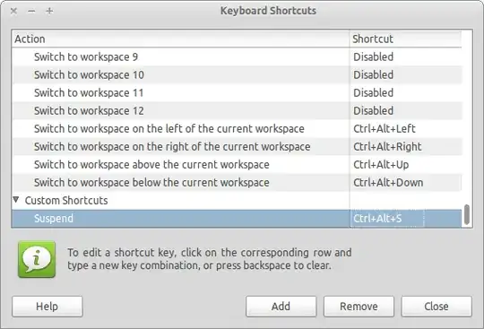

  3. Click on the newly created shortcut entry, and set the shortcut keys.
