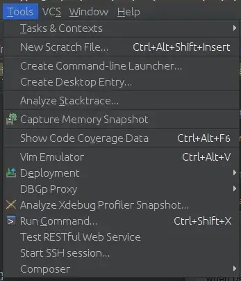

22
Go to Tools-> "Create Desktop Entry"
Phpstorm 8 Tools menu
