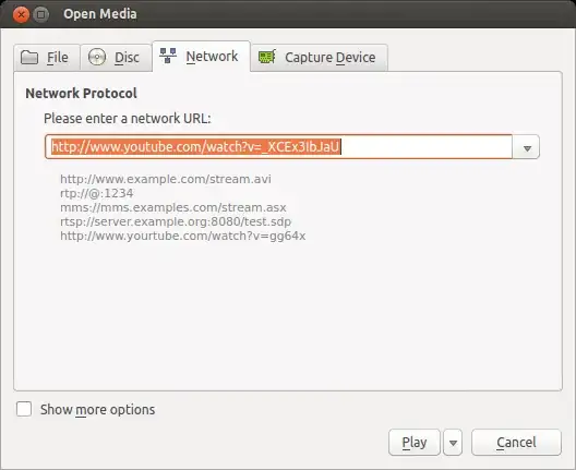

You can directly play Youtube videos from VLC media player. In VLC menu, go to Media > Open Network Stream and enter the video URL.
Youtube Video
If you get a lua error , you need to update your VLC's youtube parser as explained in this answer.
