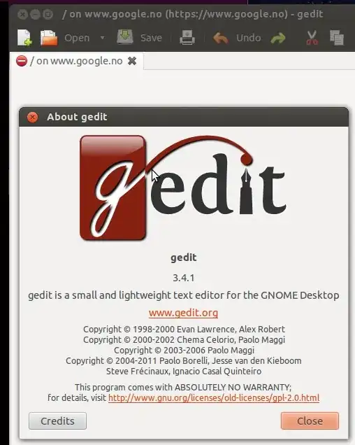

I save links as files, rather the using bookmarks. I just drag the URL field from Firefox onto my desktop/folder.
Recently these stopped opening in Firefox, and started "opening" in Gedit. Even in Gedit, the file errors. The only way I can open these to even see the link is by using vim, having navigated to the file from the terminal.
There are a number of threads with similar problems, to solutions to which I have tried to no avail. <THIS THREAD> describes exactly my problem, but no solution is posted.

And here is a screen-shot of Gedit trying to open these: Gedit trying to open these:

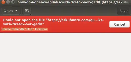

I just experienced the same problem in 16.04 where web links on my desktop was being opened on gedit instead of firefox with the error:
Could not open the file “https://...”. Unable to handle “http:” locations."'
Error - Unable to handle “http:” locations.
I was able to fix the problem by editing:
~/.config/mimeapps.list
Find the entry:
application/octet-stream=gedit.desktop;
This entry will mostly likely under the [Added Associations] heading. Move this entry to under the [Removed Associations] heading. Save the mimeapps.list file and the behaviour should be fixed immediately.
