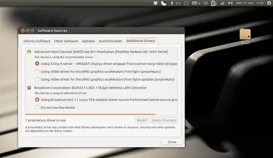

Ubuntu software center installed automatically the wifi additional driver as you can see in my screenshot.
Additional drivers and wifi issue

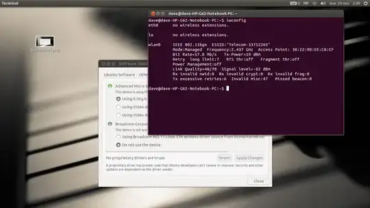

If I mark the option "Do not use the device" and apply changes, restarting Ubuntu my wifi is back and I can use it.
If I run iwconfig my terminal is showing this iwconfig

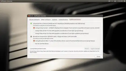

and after a restart the wifi additional driver is actived and working enter image description here
If my wifi will disconnect again I'll let you know.
