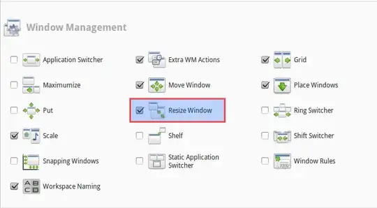

It sounds to me like you're using Gnome-classic with Compiz, and in that case resizing windows doesn't work because the plugin is disabled by default (not sure why).
To enable it, install CCSM:
sudo apt-get install compizconfig-settings-manager
Then run CCSM:
alt+f2ccsm+enter
Then in CCSM enable the resize plugin:
If resize doesn't work immediately, you may need to restart Compiz:
compiz --replace & disown

I had the same problem in 14.04.3, using Unity. Window resize just stopped working in the middle of my workday.
I already had CCSM installed. When I opened CCSSM, "Resize Windows" was already checked.
FIX: By simply unchecking (wait a few seconds, screen flickers a bit), then re-checking "Resize Windows" (wait a few seconds), the issue was fixed for me. No need to reboot or restart anything else.
