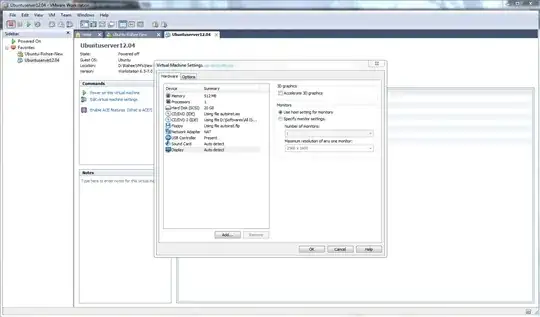

@pinouchon You need to turn off your VM then go into the settings of that VM by right clicking it. Then, go to display as shown in the below Screenshot and check accelerate 3D graphics and then click 'OK'. and start your VM it will start working fine. Let me know.
These small tricks should work. However, there are more complicated solutions to these issues which we can try if this does not work.
